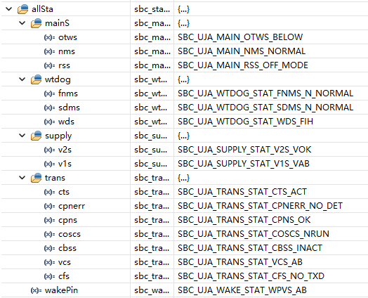

4, debugging has found that the status register 22H of trans has an error bit, as well as CTS =inact, after debugging now the status of 22H is also considered normal;

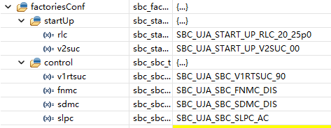

status = SBC_GetFactoriesSettings(&factoriesConf);
    //DEV_ASSERT(status == STATUS_SUCCESS);
    if(factoriesConf.control.fnmc == SBC_UJA_SBC_FNMC_EN ||
            factoriesConf.control.sdmc == SBC_UJA_SBC_SDMC_EN ||
            factoriesConf.control.slpc == SBC_UJA_SBC_SLPC_IG)
        /* Set correct settings. */
        factoriesConf.control.fnmc = SBC_UJA_SBC_FNMC_DIS;
        factoriesConf.control.sdmc = SBC_UJA_SBC_SDMC_DIS;
        factoriesConf.control.slpc = SBC_UJA_SBC_SLPC_AC;

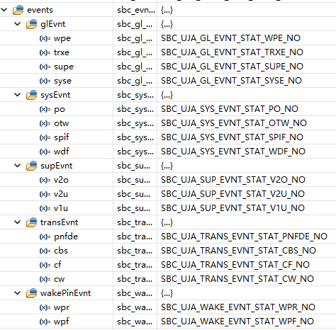

Attached are the status registers read.

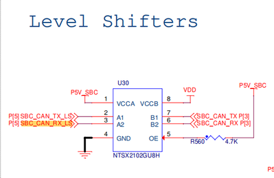

Update, it's this device, I removed it before and didn't solder it properly, now I removed it and just shorted it, I did it, I have comms!Brady_Li_0-1728617827007.png
719 Views
PetrS
good to see you found this PCB/soldering issue.
