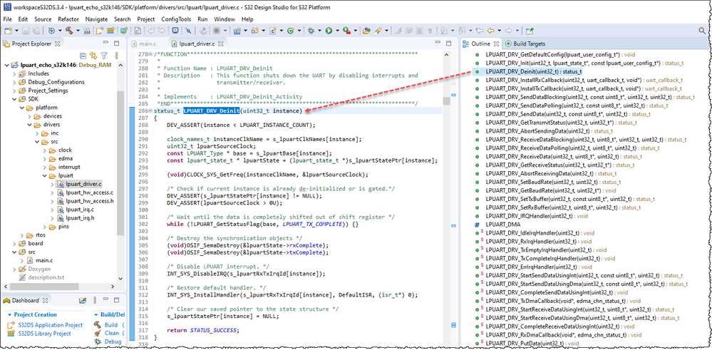

In S32k146, I have a need to disable UART permanently after end of line testing.
can you pls describe some way to do it.  which LPUART register can be used to disable it
or do we need to make some other changes.
2,772 Views
Robin_Shen
Hi MaheshSingh,
You can refer to the content of LPUART_DRV_Deinit in S32 SDK for S32K1xx RTM 4.0.2
