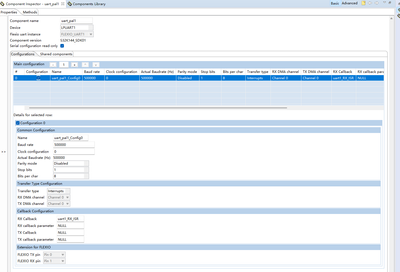

Hello EveryOne,
I just use the UART module on the MCU:S32K144 100pin, I find the UART interrupt is occured, and read the data, I find the data is same with the uart TX data,as normal design, it is not My wanted data. How can I to config the SDK, and fix the issue.

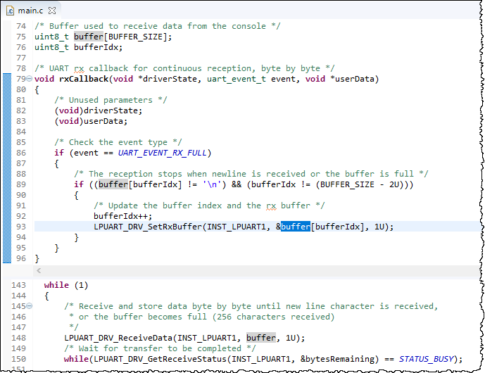

Please refer to the lpuart_echo_s32k144 example in SDK:
Call LPUART_DRV_ReceiveData start receive 1 byte UART data, the 1 byte data is already received into buffer[] after enter UART_EVENT_RX_FULL rxCallback.
Don't know why you call LPUART_DRV_ReceiveData(INST_LPUART0, &uart_Rx_Date, 1u) at line 52, the data should already in in BD18333_Read.RxData[] when enter UART_EVENT_RX_FULL event.

547416104
Hello Robin,
I just follow your suggest to reconfig the uart module, I find the issue is also occured.
when I sent data through UART, then the RX ISR is callback, debug and find the BD18333_Read.RxData value is same with the TX data.
The hope result is the RX ISR is callback only when UART receive the new data, it should not same with the UART TX data.

Robin_Shen
Please tell me how to reproduce this issue.(Maybe you can send a test project to me)
I tried test uart_pal_echo_s32k144 based on your screenshot and couldn't find the issue.
After call UART_SendData(&uart_instance, txbuffer, 1U); send data output, then call UART_ReceiveData(&uart_instance, buffer, 1U); I didn't see the value in buffer equal to txbuffer.
