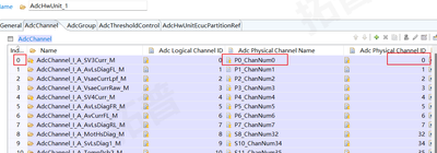

    • ​Channel Setup​​: Configured multiple channels, with the last channel indexed as ​​Channel 72​​ (as per EB28.2 configuration).

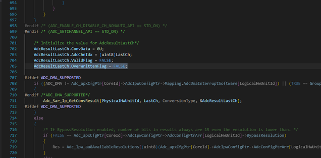

    • Debugging reveals that the function Adc_Ipw_CalculateLastChan() — responsible for determining the last converted channel — ​​consistently returns AdcResultLastCh.AdcChnIdx = 0​​ instead of the expected 72.
  3. ​Root Cause Analysis​​:
    • In the function Adc_Ipw_CalculateLastChan() (invoked as AdcResultLastCh = Adc_Ipw_CalculateLastChan(Group, ConversionType, CoreId);):
      • The initialization of AdcChnIdx defaults to 0 and ​​never updates to reflect the configured last channel (Channel 72)​​.
Subsequent logic (e.g., DMA buffer assignment) erroneously treats ​​Channel 0 as the last channel​​, causing data for Channel 72 to be skipped in the buffer.

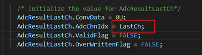

4. Code Modification​​:
Revised Adc_Ipw_CalculateLastChan() to initialize AdcChnIdx with the ​​configured LastCh value (72)​​ instead of 0.
AdcChnIdx = ConfigPtr->LastCh; // Directly use configured last channel index
​Validation Results​​:
  • Post-modification, AdcResultLastCh.AdcChnIdx correctly returns ​​72​​.
  • DMA buffer now ​​successfully captures data for all channels​​, including Channel 72.

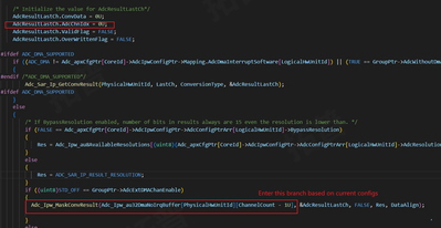

Hi@dongxun
I've taken the time to check the latest RTD versions, and the following changes have been made in RTD 4.0.0 and later, such as RTD 5.0.X and RTD 6.0.x.
This is likely a known and fixed bug. I recommend that you stop using older versions of RTD.
You may encounter new issues later, but these issues may have been fixed in newer versions,
and we don't have the resources to help you reproduce issues with older versions.
