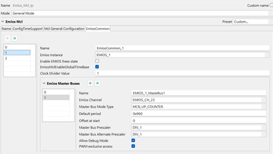

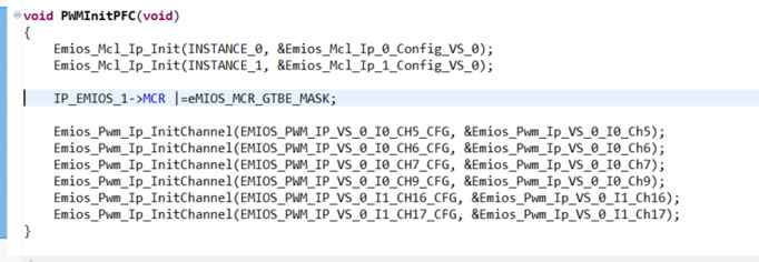

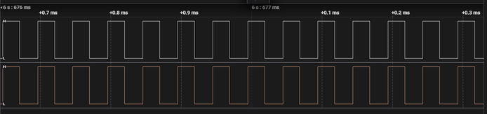

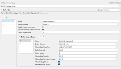

Hi@RChatterjee
Sorry for the first reply and I made some modification according to the demo your provided:
1.Clean all eMIOSn->MCR.GTBE at beginning.
2.Enable eMIOSn->MCR.GTBE after init eMIOS_MCL
IP_EMIOS_1->MCR |= eMIOS_MCR_GTBE_MASK;
3.Test Result:
PTD20 & PTB17

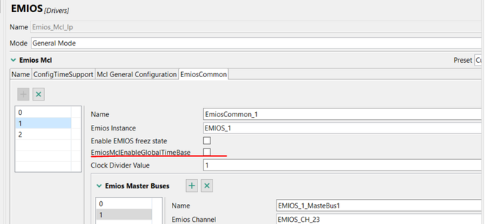

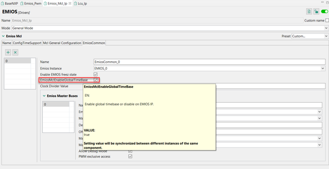

RChatterjee
Hi @Senlent ,
This is my config. I have it enabled for EMIOS 0 and EMIOS 1. However, the phase difference exists.
RChatterjee_0-1716979728857.pngRChatterjee_0-1716979728857.pngRChatterjee_1-1716979765400.pngRChatterjee_1-1716979765400.png
Should this not happen then?
PFA design files. The phase difference is between any of the emios 0 and emios 1 channels.
Rounak Chatterjee.
