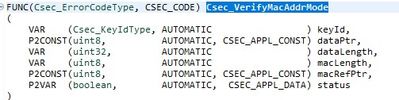

Keane
Hi Lukas,
Thanks for your reply. It helps me a lot. Now I can calculate my own MAC and store it in normal FLASH.
But now I have some issues with MAC verification.
There are 2 functions related to MAC verification, but I can't distinguish function "Csec_VerifyMacAddrMode" and function "Csec_VerifyMac".
I'm using function "Csec_GenerateMac" to calculate MAC. Should I choose function "Csec_VerifyMac" to verify MAC, too?  Should they be used in pair? Just like function "Csec_GenerateMac" and function "Csec_VerifyMac", function "Csec_GenerateMacAddrMode" and function "Csec_VerifyMacAddrMode".
I have some idea about the issue. Is it affected by " little-endian"? Firstly I used data segment filled by full 0x0, and it can verify MAC successful. Next I replaced the filled data with random data, but it failed.

lukaszadrapa
Hi Keane,
The best way is to use "Csec_GenerateMacAddrMode" together with "Csec_VerifyMacAddrMode" when generating/checking a MAC on Program Flash. Those won’t work on Data Flash or on RAM. Due to nature of these commands, you will achieve better performance because “non-AddrMode” functions will be slower due to software overhead.
And similarly, use "Csec_GenerateMac" and "Csec_VerifyMac" when your data are in Data Flash or in RAM.
So yes, use them in a pair.
There could be a problem with endianness. SHE specification provides test vectors which can be used for comparison of the results
For CMAC, the values are:
KEY      2b7e151628aed2a6abf7158809cf4f3c
MESSAGE    6bc1bee22e409f96e93d7e117393172a
OUTPUT    070a16b46b4d4144f79bdd9dd04a287c
AN5401SW expects that the numbers are provided in this form:
uint32_t key[4] = {0x2b7e1516, 0x28aed2a6, 0xabf71588, 0x09cf4f3c};
uint32_t data[4] = {0x6bc1bee2, 0x2e409f96, 0xe93d7e11, 0x7393172a};
And SDK driver expect this format:
uint8_t key[16] = {0x2b, 0x7e, 0x15, 0x16, 0x28, 0xae, 0xd2, 0xa6, 0xab, 0xf7, 0x15, 0x88, 0x09, 0xcf, 0x4f, 0x3c};
uint8_t data[16] = {0x6b, 0xc1, 0xbe, 0xe2, 0x2e, 0x40, 0x9f, 0x96, 0xe9, 0x3d, 0x7e, 0x11, 0x73, 0x93, 0x17, 0x2a};
The data are then stored in different order in the memory.
AN5401SW then works with the data as with 32bit words, SDK driver works with the data as with 8bit words, so the input data are swapped by the driver and the result is then also swapped.
Lukas

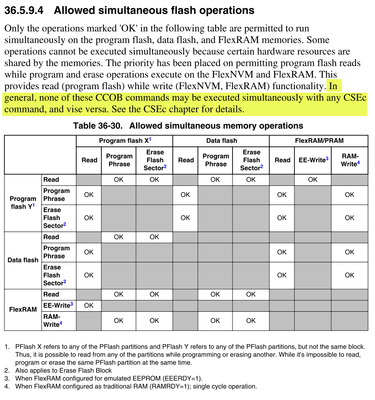

Keane
Hi Lukas
I want to add something to yesterday's e-mail since I have new progress today.
Will the simulation debug type affect the running of the program in S32DS3.4?
When I use [step into] to debug the code, it worked. But when I use [step over], reset will occur.
Keane

lukaszadrapa
Hi Keane,
if it works when stepping the code, it's caused by read-while-write error, most likely.
You can try to disable interrupts when generating the MAC.
Lukas
4,574 Views
Keane
Hi Lukas
Yes, It was casued by interrupts, which I verified earlier today. I've known the reason for reset (RCM_SRS[LOCKUP]) through function "Mcu_GetResetReason", and also found the way to figure it as you said before, too.

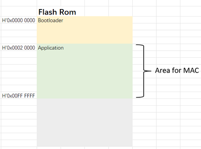

Keane
Hi Lukas
Thanks for your reply again. It really helps me a lot.
Last week I generated my own MAC and stored it in Nvram during DEBUG CASE, but I still encountered some issues in practice.
a) I want to calculate MAC for application area like the following picture. The way I got my own MAC is to read data from FLASH ROM to buffer first, then use "Csec_GenerateMac" to calculate MAC for buffer. Is there other method free from reading from FLASH ROM firstly? (I tried to use header address of application as formal parameter, but it didn't work till I read it to buffer.)
b) Is there limited length of "Csec_GenerateMac" to calculate MAC? I tried some cases, but they didn't work when length >0x3B0. (Not very accurate, just vague data).
c) If I want to calculate MAC for application area like following picture through using header address of application as formal parameter, what am I supposed to do?
Keane
