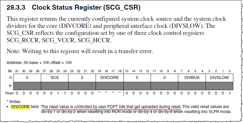

Hi Friends,
what is the default frequency of core and system clock of s32 microcontroller??
I am unable to the reset value of SCG_RCCR[DIVCORE] which defines core and system clock

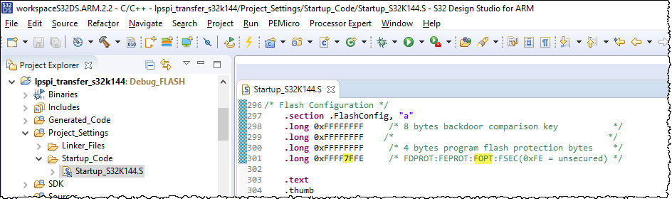

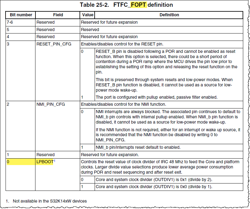

Robin_Shen
Hi Kishore,
Please refer to the FOPT value in /* Flash Configuration */
Clock Status Register (SCG_CSR) DIVCORE.pngFTFC_FOPT[LPBOOT].pngFlash Configuration FOPT.png
Hope it helps.
