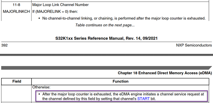

Hi @Furkan07,
Although the FlexIO SDK driver does not support it, the DMA channel can be triggered again at the end of the Major loop.
TCDn_CSR[MAJORLINKCH] can be set the n channel.

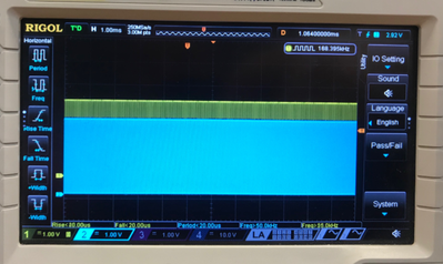

Furkan07
Yes, you are right. I was able re-trigger the DMA channel when the DMA data send finished for creating a continuous DMA transmission. Result; (blue: clk, yellow: data)

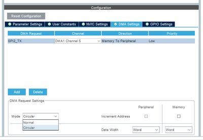

But it took some time to figure out how to do it. Even the simple process of sending a string continuously requires reading quite a few resources on the minor loop and the major loop. The fact that NXP doesn't do it as simply as in CUBE MX is challenging for NXP beginners.
