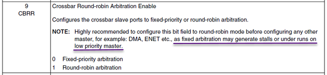

Is round-robin arbitration enabled?
BR, Daniel
6,864 Views
nathand
Round-robin arbitration is disabled (the default, with both SDKs). Enabling it did not make a difference.

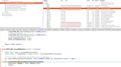

I put a breakpoint in lpspi_slave_driver.c at line 444, (void)LPSPI_DRV_SlaveAbortTransfer(instance);
When the breakpoint occcurs, here's what I see
The Enable Request Register ERQ shows no bits set. When the transfer is first started, bits 0 and 1 are set. Any ideas what would be clearing those bits in the middle of the transfer, if that seems like it could be the problem?
6,833 Views
nathand
I added an additional breakpoint on the DMA Error Interrupt Handler and that never gets hit, so it does not appear that that there are any DMA errors. Instead it looks like for some reason the DMA gets disabled before the transfer completes.

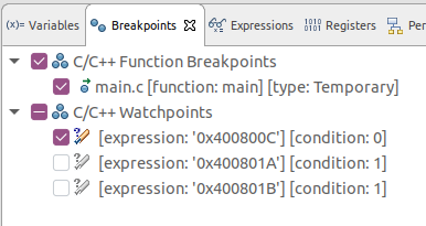

nathand
Is this what you were suggesting? I've added a watchpoint on DMA->ERQ (0x400800C) and I don't see the watchpoint getting hit. If I enable the watchpoint on the SERQ and CERQ registers (0x400801A and 0x400801B) then the code doesn't run at all, no idea why.
6,748 Views
danielmartynek
I just noticed the address is not correct,
You have 0x400800A instead of 0x4000800A.
Can you test it again?
6,725 Views
nathand
Good catch on the addresses. I now see that watchpoint getting hit but I haven't managed to get my code to the point where it gets hit only unexpectedly. My application starts in normal RUN, then transitions to VLPS on a command received over SPI, and I have not been able to get the breakpoint set so it only executes after that transition.

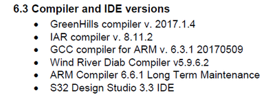

danielmartynek
Hi Nathan,
Which version of the S32DS IDE do you use?
As per the SDK RTM 4.0.1 Release notes, S32DS 3.3 is supported only:
