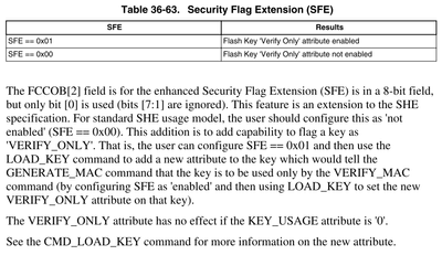

I'm working in a project having the CSEc module (microcontroller S32K144). I know that, in order to update SHE-keys, 5 flags must be configured in order to generate the key in the M-format (Write Protection, Boot Protection, Debugger Usage Protection, Wildcard Protection and Key Usage Flag).
In some documents, I read also about Verify Only flag: if set when the key is used for CMAC, it can be used only to verify CMAC, otherwise the key can be used for verification and generation.
The question is: the flags are actually 5? what about the Verify Only flag?
Thank you in advance

This is an extension to SHE specification. Search for "SFE" keyword (Security Flag Extension) in the reference manual and in the application note AN5401. This is a screenshot from the reference manual, description of Program Partition command:
If you don't want to use this extension, just keep SFE as 0 when running Program Partition command.

Ok, now it is clear.
Many thanks!
