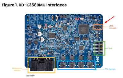

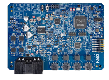

bryan_hong
Senior Contributor I
dear nxp
I have above EVK, and I want to downlaod fw to this.
but I can not found any USB port to download fw.
Bryan

petervlna
The EVB has JTAG connector:
 Debug Interface Options on the S32K358 BMS EVK
The board supports debugging via:
  • JTAG/SWD interface (standard for ARM Cortex-M)
  • Serial UART (for FreeMASTER GUI and basic communication)
  • TPL Gateway (for battery cell monitoring chains)
Please refer to the user guide:
https://www.nxp.com/document/guide/getting-started-with-the-hvbmsct800bun-reference-design-bundle:GS...
