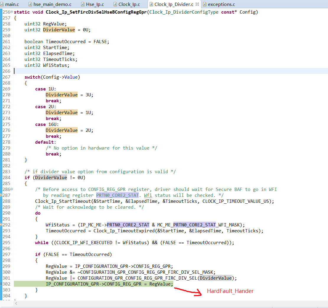

I can run my project normaly ,but  for the same  project it will trigger Hardfault after  installed HSE Famewire, the project don't include anny HSE oporation ,what caused this different situation

Do you have compatible version of HSE FW and SBAF? Also don't forget HSE FW installations changes memory layout.

I have found the exact site of the problem , but i don't know how to solve it,Can you give me some advice.

“The host must wait for HSE_STATUS_INIT_OK before changing the device clock configurations like enabling PLL.” - it is common source of issues.

I have add the code wait HSE Init OK in my test project,  But it still Triger HardFault_Hander in the Clock_Ip_Init() Process

I would recommend to run HSE_CLK at 60MHz.

I have temp to fix the HSE_CLK to 60Mhz,but it  not  work.

After i Installed HSE FW for my S32K312 bord ,my project trigered Hardfault in the Mcu_InitClock();this picture show my Clock configration,Does it have anny problem?

I used the SHE_install_FW Project to install the hse fw,I checked the memory and the FW version it was installed sucseefully, My project used standered RTD link file and start file, it will go to hardfault when run the Mcu_InitClock(McuClockSettingConfig_0);what should i do to deal with this issue
