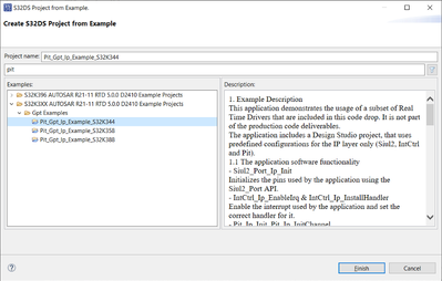

I am using the S32K344 microcontroller and would like to configure the PIT timer without generating interrupts. Are there any examples available in the NXP community that I can refer to? I'm using SDK peripherals and SDK drivers for this purpose

By "SDK" I am assuming you are referring to the Real-Time Drivers (RTD) package, since there is no RTM version similar to S32K1 for the S32K3.
 The RTD includes the "Pit_Gpt_Ip_Example_S32K344" project, which triggers a notification:
You can also look at the PIT and STM with RTD training, which features GPT PIT overview, how to configure and an example.

However, the PIT module does not support polling (hence the name, Periodic Interrupt Timer). If you need to poll until enough time has passed, you can set a flag on any PIT interrupt and poll by application until the flag is set, or simply use a delay function (such as osif_delay) to wait until enough time has passed.
