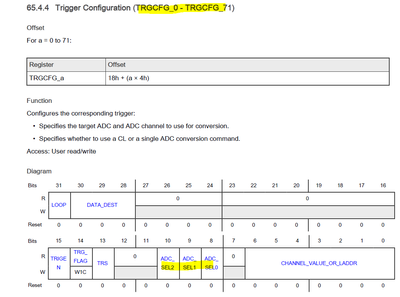

Set PIT Freeze Enable :---

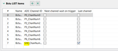

All channels are for ADC-1 , in BCTU list :--
"NEW DATA DMA enable mask" :--
controls These bit field in MCR register
"ADC target mask" :--
It controls "ADC_SEL " bit field in "Trigger Configuration (TRGCFG_0 - TRGCFG_71)"
for single conversions you can enable only one instance
so the possible values for target mask:
1 (0b001) ADC0
2 (0b010) ADC1
3 (0b100) ADC2|
for list of conversions we can enable also parallel con version
for example
3 (0b011) parallel conversion of ADC0 and ADC1
The trigger is configured as a list of parallel conversions ADC0, ADC1 in “Adc Target Mask”.
List of ADC channels is defined in “BCTU List Items” while order is given by the “Adc Target Mask”: BctuListItems_0 is ADC0, BctuListItems_1 is ADC1 etc.

Using TriggerMux and Testpoints inserted in the DmaCh0_Callback function I tried to measure the time elapsed between the trigger (PIT CH0) and the reading of the data via DMA.
To make sure I measured the time of only one conversion I checked the "Next channel wait on trigger" option on all elements of the BCTU list. I left the other settings in the example (clocks, adc sampling durations = 220, ...).
The duration of the acquisition is about 13 us, which seems to me to be a VERY long time.
Can anyone help me understand how to get me on the 2 us to acquisition?
