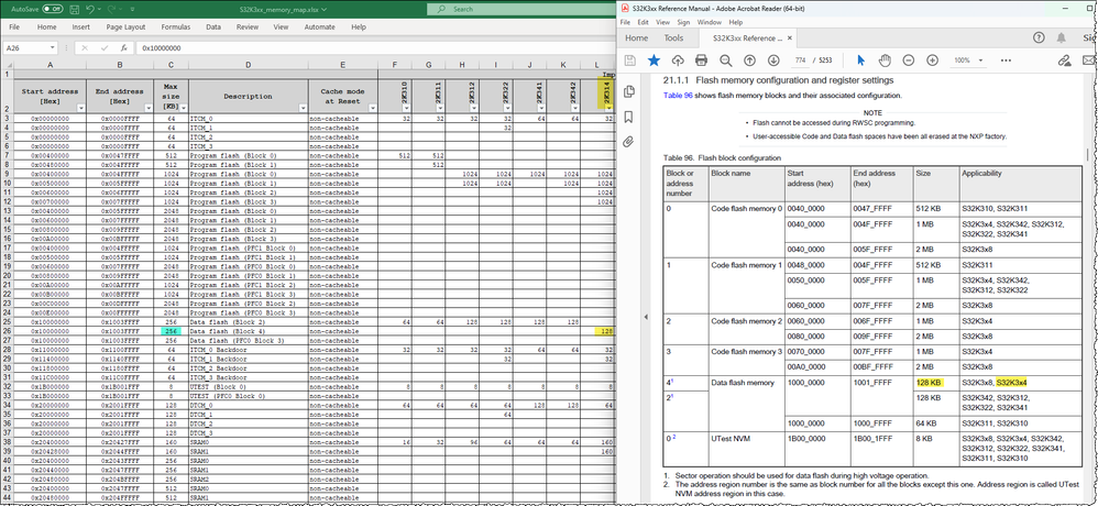

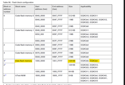

Robin_Shen
The Data Flash Memory is a block of 256 KB but 128 KB is reserved to the HSE and this region is protected by hardware.
So it have min 100,000 P/E cycles.

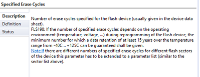

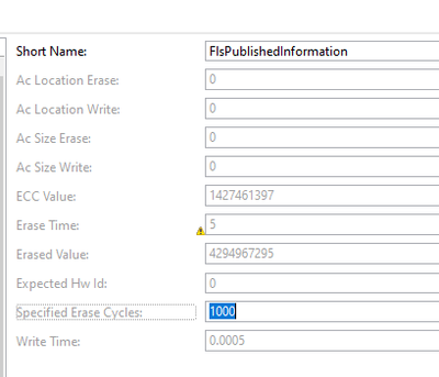

sharonfmc93
Hello Robin, thank you for answering my question. I understand now. Then the value of 1000 specified here (taken over from MCAL) is wrong right?
5,954件の閲覧回数
Robin_Shen
Sorry I am not familiar with Davinci configurator, please take a screenshot and tell me under which component I see this information.
Also, which version of S32K3 RTD are you using?
5,935件の閲覧回数

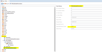

sharonfmc93
Hi Robin, thanks for the reply, we are using MCAL version SW32K3_RTD_4.4_2.0.2.
i see this parameter under FLS, flash driver.
its actually specified within MCAL/RTD delivery -
i'm not sure if this value is really 'used'.

Robin_Shen
Sorry, I am not familiar with MCAL.
The data flash of this MCU have 100,000 P/E cycles. But the program flash is 1MB which have 1000 P/E cycles.
I am not sure whether this parameter is for data flash or program flash.
