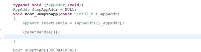

Hi Team,
I am trying to configure Bootloader jump to application in s32k311 MCU but not able to configure it.
Can you please support on this.
Kiran

kiran5
Hi Senlent,
Thanks for Providing the Reference code, but the issue is still not solved.
Please take a look at the code which we are using.

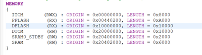

Application Linker File:

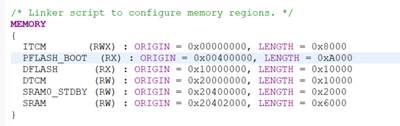

Bootloader Linker File:
The Jump to application code used is as per the s32k312 code.

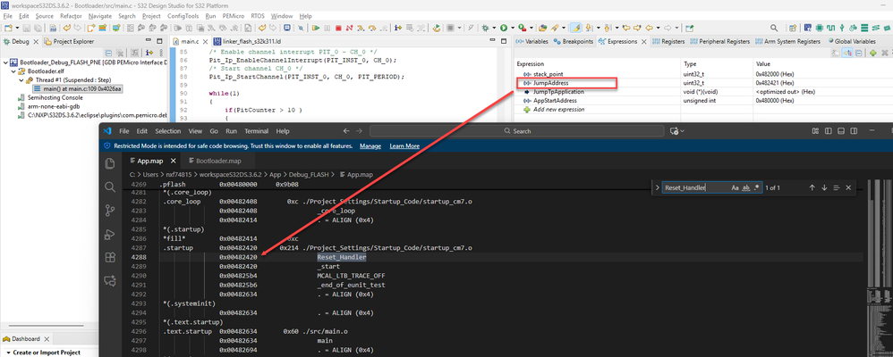

 When i run in Debug mode it is going to Default handler in the bootloader code.
If i add VTOR relocation SCB->VTOR = (0x0044A200 ); then it is not going to default handler, but still Jump to application is not happening.
I have used the offset as per s32k312. Can you please let me know if the offset for s32k311 is different as i am not able to get the information.
