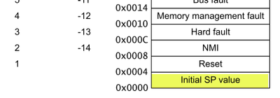

Let me re-use text about jumping from bootloader to application I wrote earlier - see below. In addition, be aware that it's necessary to de-initialize all the features used by bootloader, especially it is necessary to disable interrupts on all levels - in the core, by local enable bits in peripherals, clear pending interrupts...
In case of ARM devices, stack pointer is initialized automatically after reset using “Initial SP value” in the vector table:
So, bootloader’s code should initialize the stack pointer as a first step and then it can jump to the application.
