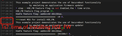

I would like to ask how long it takes to install HSE_FW.
According to my understanding,
when the HSE Firmware Usage feature flag (0x1B00,0000) and LOAD_ADDR are configured, reset the MCU, install the HSE_FW, and jump to APP core after the installation is complete.
1. My actual test installation time is 1s, is this time correct
2.jump to APP core after the installation is complete,In this case, the value of FSR is 0, that is
after first reset HSE_STATUS_INIT_OK is 0, after second reset ,HSE_STATUS_INIT_OK is 1,Is this a normal phenomenon?Is this the internal logic of HSE_FW?
3.After the first reset, after jumping to APP core, whether the installation HSE_FW process has ended,
and Whether there is a need to wait for a certain amount of time before the second reset
Luhaiou
5,218 次查看
lukaszadrapa
1. Yes, the installation should take about 0.8s - 1s, so it's expected value.
2. The HSE FW is installed after first reset. To make it running, another reset is needed. And if you use AB SWAP version, one more reset is needed beucase HSE FW needs to be programmed also to passive block.
3. Once the HSE FW is installed, you need to always wait after reset till HSE_STATUS_INIT_OK bit is set before triggering a service request to HSE.
