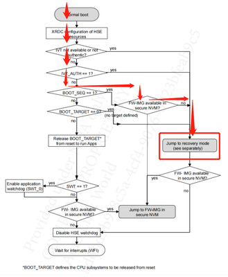

I have some doubts about the start-flow of the s32k3, and I hope to get your solution to it.
There is a machine that uses s32k314, HSE Firmware Usage feature flag(0x1B00,0000) is not program, HSE_FW is not installed.And the bit  IVT_AUTH is set 0, BOOT_SEQ is set 1, IVT.pHSE is set 0.The machine is able to start normally.
I have some doubts about the Start-up flow on the manual of RM758222-HSE-B Firmware Reference Manual - V2.2(2.2).pdf.
1. Looking at the flowchart, the device should go into recovery mode, but my machine boots normally, why is this happening?
2.There is no mention of the judgment of HSE Firmware Usage feature flag (0x1B00,0000) in the flowchart, I think this is a very important parameter, please help sort out its judgment logic
We look forward to hearing from you, thank you very much.
785 Views
lukaszadrapa
If HSE FW is not installed (HSE feature flag not set, HSE FW not installed etc.), the device won't enter recovery mode. That's possible only if HSE FW is installed.
I saw there are some internal documentation tickets related to these flowcharts, so it will be updated in the future.
Lukas
