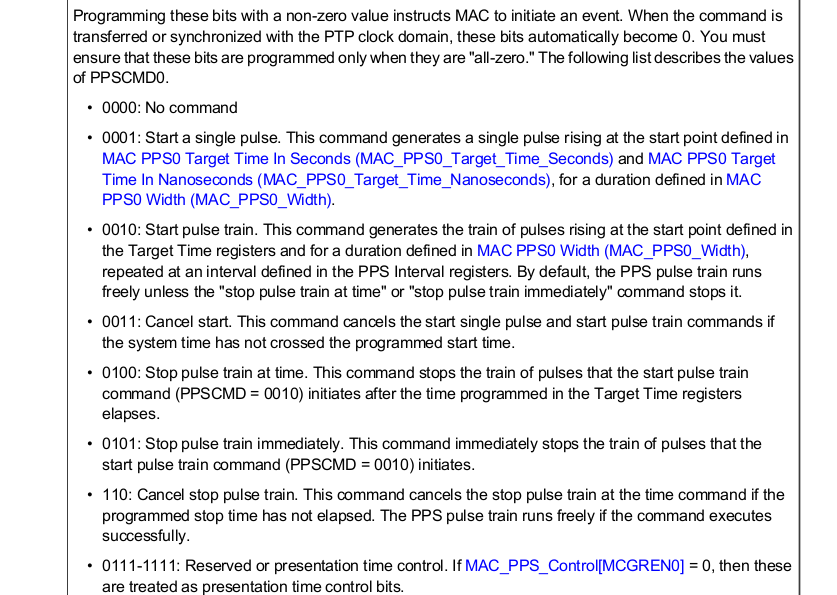

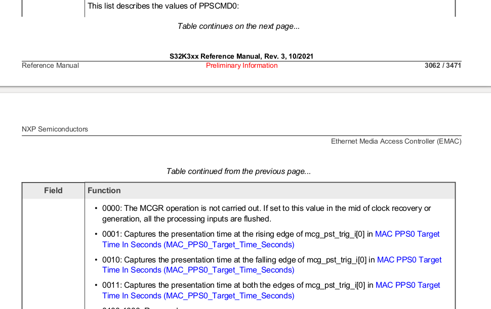

In S32K3 RM, in chapter "73.17.167 MAC PPS Control (MAC_PPS_Control)" it says that PPS0 can be used to capture presentation time at rising/falling/both edge of a media clock.
But the same values of PPSCTRL_PPS CMD are used also above in the manual:
How is it defined which of the above value sets are effective, pulse train or timestamp capture on edge?

Hi Jakub,
The attachment is a draft version of PPS user guide. You can refer to it.
