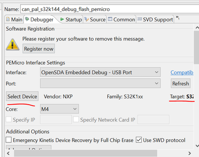

A debug problem was encountered when I launched the debug configuration on my s32k144 board, the problem was indicated like this:
Missing mandatory device name. Fill-in the 'Device name:' field in the Debugger tab.
Please tell me what I should do to solve it, thank you!
2,602 Views
Senlent
Hi@luoxg
have you select device?
for example.
