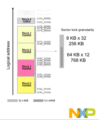

 we have to map all the flash memory (S32K3 f.y.i.) for different SW levels (Bootloader, Tunables, Main Application, NVM, etc etc) but there is something not totally clear for me.
According to the picture below
we have (8KB x 32) and (64KB x 12), for a total amount of 1MB of Flash for Block.
But what is the sector lock granularity for Block 4 Data Flash? 4 blocks of 32KB each one or 2 blocks of 64KB?
Andrea
