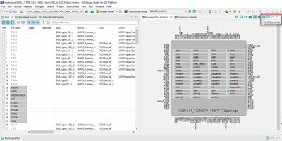

tecprasant
@Julián_AragónM : Thanks for the inputs. This answers my query.
I have an additional query: If I want to only change the MCU package, say from S32K344 172 pin package to 100 pin package, then what is recommended?
(a) I create a new project?
(b) I change the package in the NXP package selection (in the same project) ?
221 Views
Julián_AragónM
Hi @tecprasant,
For changing the package, this can be done inside the S32DS Config Tool (option b), just keep in mind the difference between these packages and modify the pin configurations accordingly.
Julián
