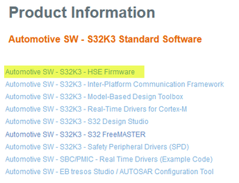

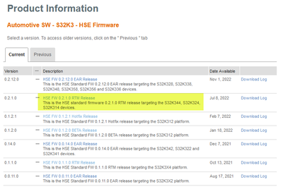

Hi Lukas
If our platform is S32K312, we can't use RTM 2.1.0 version(For S32K344), right?
We use S32K312 (HSE FW is 1.2.1).
3,203件の閲覧回数
lukaszadrapa
Yes, that's correct. Those are two different versions.
