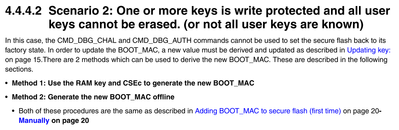

How can I update BOOT_MAC when secure boot is activated.
!!! I need to avoid erasing csec keys (returning to factory state). !!!
Best Regards
Phillip
1,892 Views
lukaszadrapa
Hi Phillip,
this is described in the AN5401:
So, the procedure is the same as when updating a key. You just need to calculate the new BOOT_MAC somehow.
