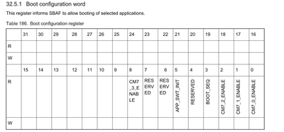

I'm using the S32K358 with RTD 3.0.0.
I was able to start the CM7-2 using the IVT table ( add CM7_2_ENABLE define to update the boot header section i startup_cm7.s ), I can debug using TRACE32, the two core runs.
But when i'm not using the IVT table (CM7_2_ENABLE  not define) I'm not able to debug/ start the SW In fact TRACE32 give me a warning after download : Warning C0:1 Core unexpectedly in running state
I used the same trace32 script for the two test.
I am bit confused here. So you didnt used IVT at all or just didnt enabled core2 in IVT?
Your warning looks liked to the script and it says that core0 is running. I feel like you do not have set IVT properly in second case and there is missing address or something essential.
Please double check it.

So yes I used IVT just don't enable core2.
I'm not able to send you Screenshot right now. but i attach the script i used.
step:
  1.  download the sw.
  2. An error message on TRACE32 => just after  SYStem.Down / SYStem.Up Warning C0:1 Core unexpectedly in running state
In the windows Core.list I see core 0 and 1 that correspond to CM7-0 et CM7-2. and Core 1 is in running state just after System.up . So i think it why TRACE32 complains.
I don"t understand why the core is running and how to manage to connect to core 2 in this case.
Like I said if the core 2 is enable in the IVT table, TRACE32 is able to "connect" to the core 2 without problem.

I expect that issue is in cmm script. Since it is expecting core 1 to be active via IVT right out of reset.
But your is not. Please try to modify the cmm script by removing the core 1 dependencies.
Also if that does not help, please get in touch with Lauterbach support as you most probably will need different script for this case. I do not see this as issue lined to micro.
