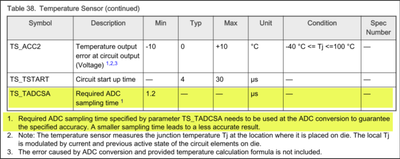

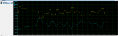

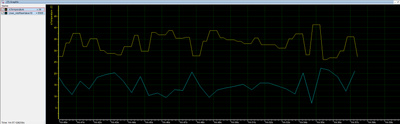

The IC temperature value was obtained from the ADC0-19 channel and calculated using the code shown in the figure below. However, the temperature value fluctuates severely. What is the reason for this? How to solve it?

Hi@liyongfeng
RTD 2.0.0 and test result, very stable.

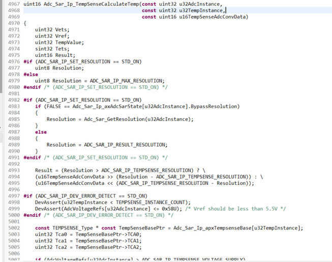

Senlent
Hi@liyongfeng
We have provided you with API functions to calculate temperature sensor conversions
please test the function below:
Adc_Sar_Ip_TempSenseCalculateTemp();

liyongfeng
I used this API, but there was no improvement. The temperature value is still jumping
According to parameter TS-ACC2, Is it allowed for temperature fluctuations to occur within the range of ±10 ℃?
