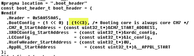

The example S32K344_Basic_SecureBoot is complete example. BOOT_SEQ in boot configuration word is already set in this project, so secure boot is enabled right at the beginning:
When you load the project first time, the debugger sets the program counter "manually" at entry point (i.e. the boot header and BOOT_SEQ has no effect now). So, S32K344_Basic_SecureBoot project is executed. It performs the configuration of the secure boot. After next reset, S32K344_SecureBootBlinky will be executed if the secure boot is successful. If not, it will go to JTAG recovery mode. To execute S32K344_Basic_SecureBoot again, it would be necessary to change BOOT_SEQ to 1.
Another options is to keep BOOT_SEQ 0 and then change it manually in the flash once you want to turn the secure boot on.

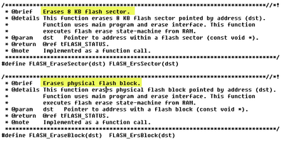

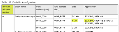

lukaszadrapa
1. What kind of error did you get?
2. Where the code is running from? Notice that read-while-write is supported only between blocks. If you are running flash operation on block 0, the code must be executed from another block or from RAM.
3. Do you really want to erase whole block? This command (status = FLASH_EraseBlock(pIVT);) will erase whole area 0x40_0000 - 0x4F_FFFF:

lukaszadrapa
I'm sure that code like this works:
PFLASH_Unlock(PFLASH_BL0, PFLASH_SS0, PFLASH_S0);
status = FLASH_EraseSector(0x400000);
status = FLASH_Write (0x400000, data, sizeof(data));
However, as I wrote earlier, the code must run from another flash block or from RAM. An option how to move a function which triggers flash operation and which waits for completion of the command is to move it to data flash block, for example. You can create own section in dflash in linker file like this:
.dflash_code_section :
*(.dflash_code_section)
} > DFLASH
And then add this attribute before FLASH_ExecSeq() function in flash.c:
__attribute__((section(".dflash_code_section")))
tFLASH_STATUS FLASH_ExecSeq (register uint32_t mask)
This will force the function to data flash.
Then be aware that FLASH_EraseSector() will erase 8KB of flash. If there's your code (and it really is in default S32K344_Basic_SecureBoot example) then it will run away after return from FLASH_ExecSeq() because you erased your code. Solution: shift your code, so it starts at next 8KB sector. Keep only IVT in the first sector.
