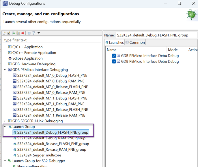

when I create an application project in Design Studio 3.6.x for K322,
I can debug the M7_0 core with my PEmicro and the Debug_FLASH_PNE configuration.
When I try to debug the M7_1 core, I cannot establish a connection to this core.
In console there is an error message:
"Could not connect to semihosting port due to connection timeout. Please check that the correct port number is configured."
The status always is halted at 95%.
At the end there is an error window with message: "error 138".
I checked that there are no breaking points at start up for the other core.
I also checked that I am using the 100-pin K322 and I checked the correct clock settings.
I checked that in both mex-files.
Can anybody help me please?

Hi @Micha4566465,
Debug both cores in Launch Group:
Let me know if you have questions,
BR, Daniel

Micha4566465
That was the problem.
Thx
