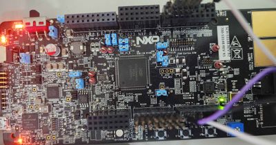

I don't know how to connect MOSI to MISO to verify the data, is there any instructions?
And I'm running on this board.
btw, I used the example on this webpage(used LSPI2, without dma), deleted the configuration, used 1M baudrate, and tested it. The waveform was correct.

I currently solved the problem, I cleared the RxBuffer
