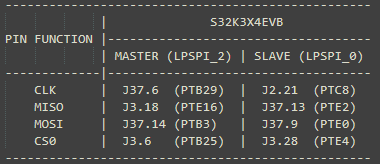

* Detailed Description:
The purpose of these demo applications is to present a usage of the LPSPI Driver together with DMA Driver (IP and MCAL) for the S32K3xx MCU.
The applications uses the LPSPI driver to transfer data between LPSPI2 (master, no DMA) and LPSPI0 (slave, with DMA) physical units.
* Connections
* Test HW: S32K3X4EVB-T172
* MCU: S32K344
* Debugger: S32DS 3.5, PEMicro Multilink Universal FX rev.B
* Target: internal_FLASH
