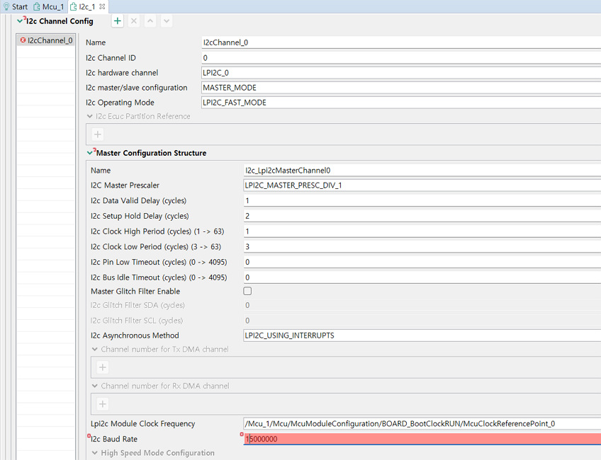

Hello.
How can I set I2C baud rate for S32K312 MCU ?
Source clock from AIPS_SLOW, 30 MHz.
I want to set baud rate to 400 Kbps.
How can I set this config page ?
SEAN SUNG
1 解答
4,003 次查看
Robin_Shen

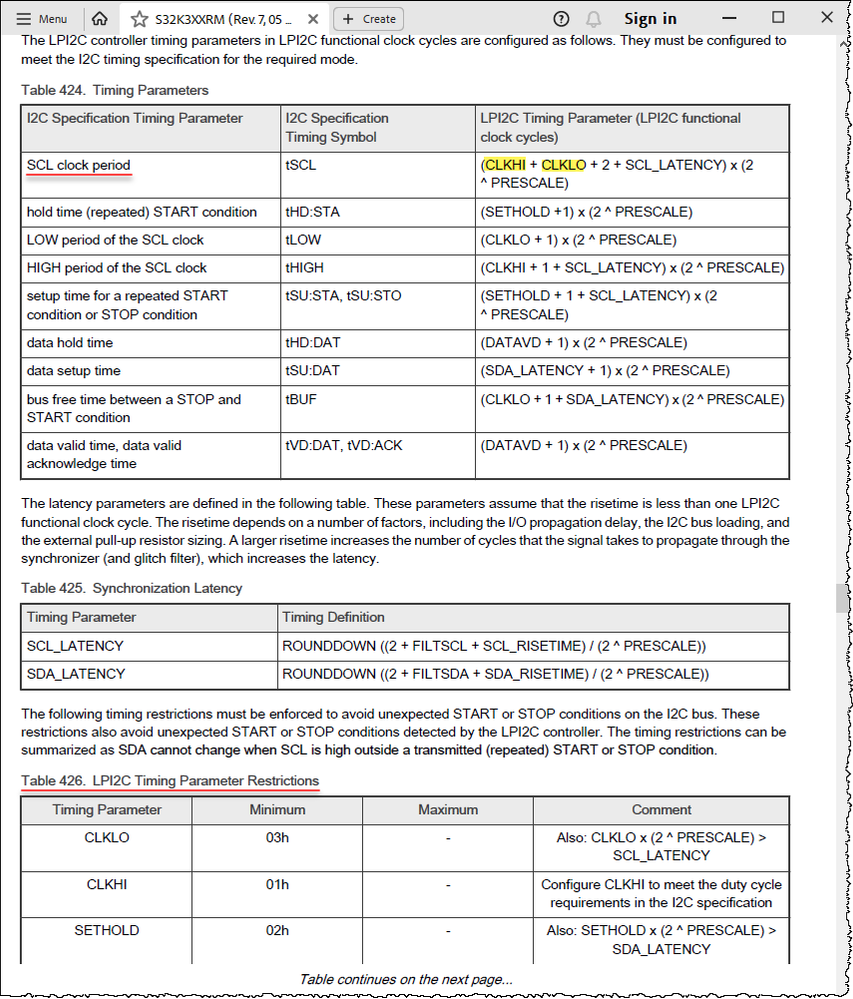

Please refer to the Table 424. Timing Parameters of S32K3XXRM. Modify the value of I2c Clock High Period(CLKHI) and I2c Clock Low Period(CLKLO). The I2c Baud Rate will be automatically calculated based on your input value and will be displayed there. But the value you configured now is too small, causing it to exceed the Baud Rate upper limit of LPI2C_FAST_MODE (so it is displayed in red). Please also note: Table 426. LPI2C Timing Parameter Restrictions

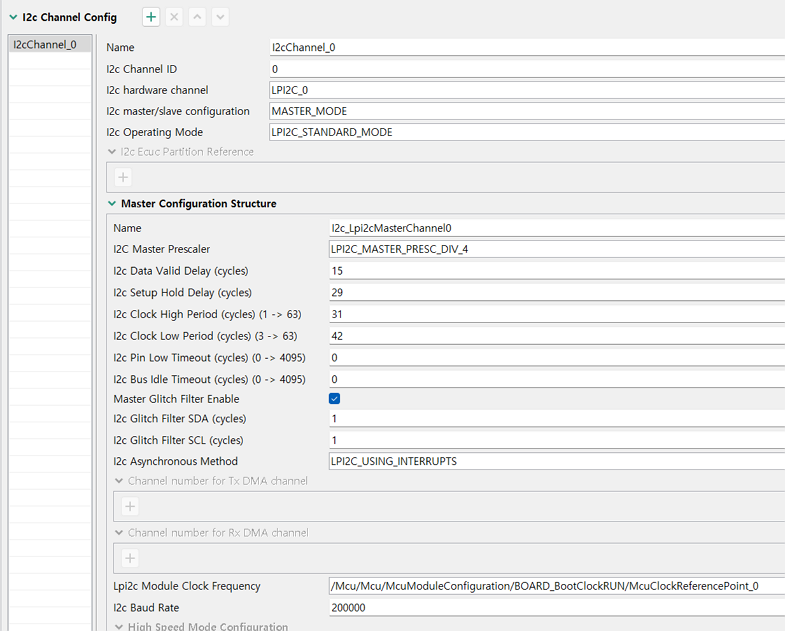

ssean
Dear Robin.
Thank you for reply.

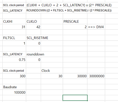

I set CLKHI=31, CLKLO=42, FILTSCL=1, PRESCALE=2 (DIV4)
My calculated baud rate is 100000 (100K).
But S32DS auto calculated baud rate is 200000(200K).
What is my miss?
Could you check my project(attached), please?
And.. HAPPY NEW YEAR!
SEAN SUNG

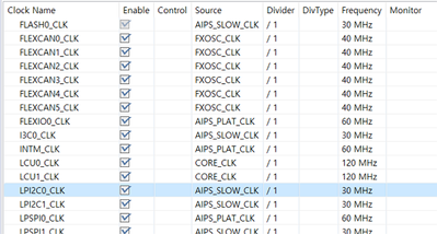

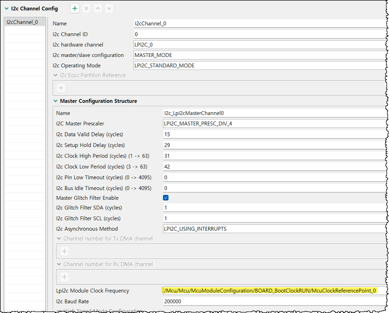

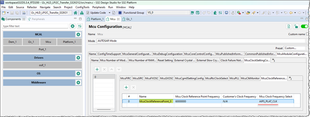

I2c Baud Rate is calculated according to the Lpi2c Module Clock Frequency, not according to the Source in Clock Tools.
Since you selected AIPS_PLAT_CLK for McuClockReferencePoint_0, but the MODULE_CLK of LPI2C should be AIPS_SLOW_CLK. This caused S32 Configuration Tool to incorrectly calculate the baud rate of LPI2C using AIPS_SLOW_CLK.

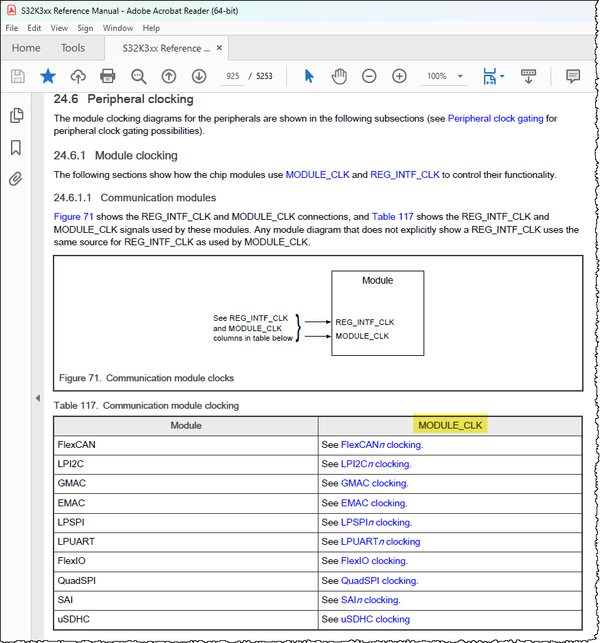

Sorry, S32 Configuration Tool does not check whether the customer selection complies with Table 117.Communication module clocking in S32K3XXRM.
