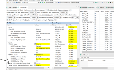

Daniel_Wax
I was looking at our eval board where we connect to one of our phys that supplies the clock for RX and even though its an external clock we still setup the RX clock to be enabled in the clock setup.
You project does not enable this RX clock.  maybe you can try that?
