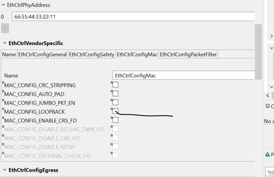

I was talking about this loopback
I now see we also call EMAC GMAC from the driver setup standpoint
GMAC registers are not applicable ... only EMAC  100Mbit only  no Gigabit
There are some registers that may be useful.  I See others as well

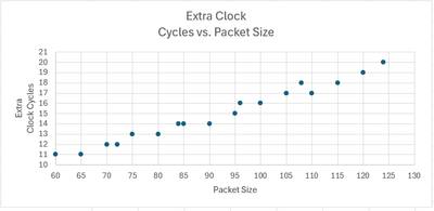

Some updates, we are definitely seeing extra nibbles in our RMII TX data.
However, even with the data on the wire being corrupted, we sometimes see a CRC that would match the packet that was intended to be sent out. Which would imply to me that the correct packet is reaching that MAC.
Here is a graph showing the extra clock cycles we see based on the packet size.
For example, for a 60Byte ARP packet, we are expecting to see 72Bytes on the wire (7B Preamble + 1B SFD + 4B CRC). 72Bytes * 20ns/(di-bit) * 4 (di-bit) / Byte = 5760ns.
However, when we measure on the wire we see 5980 ns for the frame. This was measured using the DV signal.
We've tried looking at the registers, comparing the clocks, power supplies, not sure how to explain the extra nibbles.

Looking a bit more into the extra clock cycles, if I take the measured packet transmit time and back-calculate what an expected clock frequency for it would be I get a clock frequency of:
48.25 +/- 0.045MHz.
The clock I'm providing for EMAC_RMII_TX_REF is a solid 50MHz so I'm wondering if it could be something in the clock configuration?
This could be grasping at straws here, but we're getting desperate.
