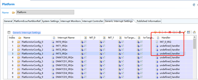

chuanlin
When using the tool to configure the Platform module for S32K344, INTx_ How to write the handler name of IRQn, such as ADC0_ IRQn's is Adc_ Sar_ 0_ Is

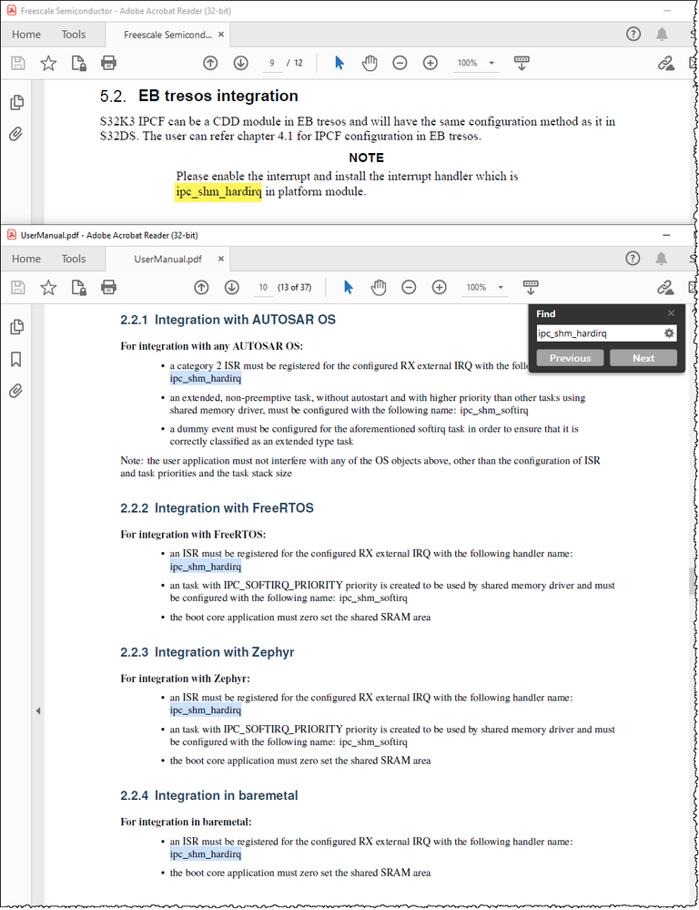

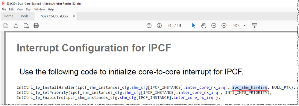

Hi chuanlin,
IntCtrl_Ip_InstallHandler ipc_shm_hardirq.pngIntCtrl_Ip_InstallHandler ipc_shm_hardirq.png
Did you install the SW32K3_IPCF_3.4.0_D2112.exe?(C:\NXP\SW32K3_IPCF_3.4.0_D2112\UserManual.pdf)

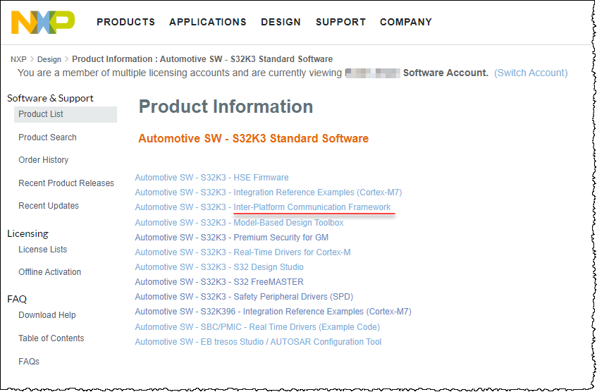

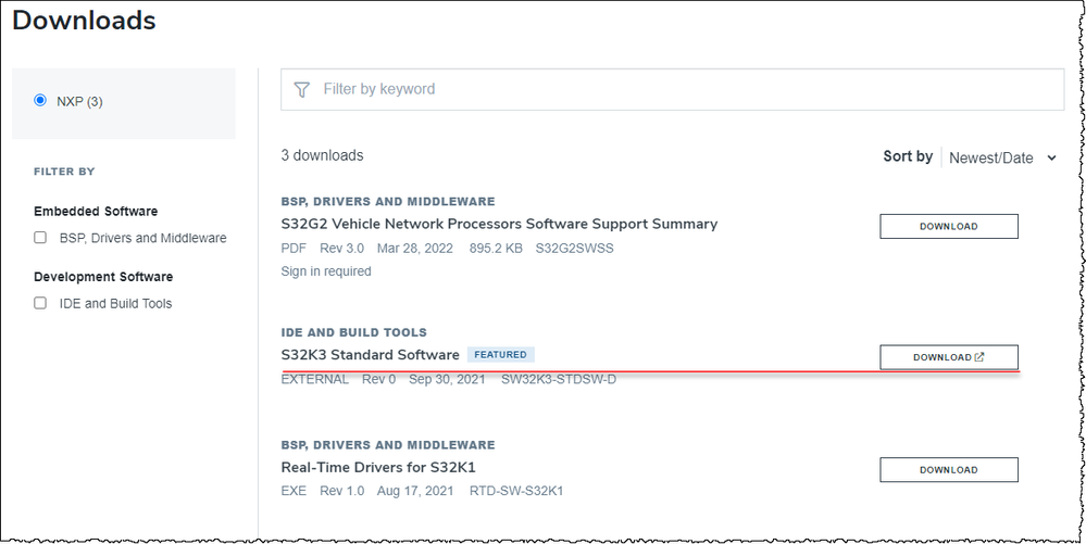

Please download lPCF from Real-Time Drivers (RTD), after click DOWNLOAD of S32K3 Standard Software you should be able to see the Automotive SW - S32K3 - Inter-Platform Communication Framework
S32K3 Standard Software DOWNLOAD.pngS32K3 Standard Software DOWNLOAD.pngAutomotive SW - S32K3 - Inter-Platform Communication Framework.pngAutomotive SW - S32K3 - Inter-Platform Communication Framework.png

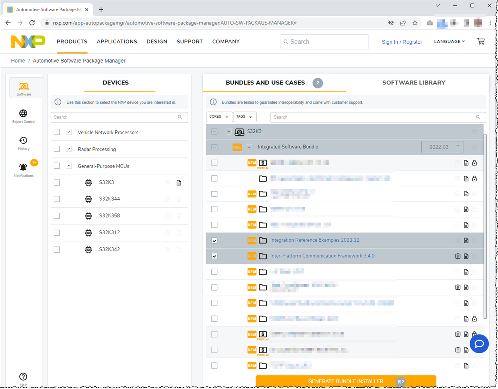

Robin_Shen
Can you download those two software after click it?
