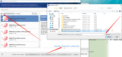

chuanlin
Hello, have you installed this site package? Will the relevant plugins that need to be installed be displayed in the third step column
2,133 Views
jiri_kral
S32K3 IPCF v3.4.0 is not compatible with S32DS v3.5. You need S32DS v3.4. With S32DS v3.5 you can use IPCF v3.7.0.
2,124 Views
chuanlin
Hello, I haven't found any S32DS engineering examples suitable for S32K324 in IPCF3.7.0 or 3.6.0, but IPCF3.7.0 has S32DS engineering examples suitable for S32K358.
2,121 Views
jiri_kral
Based on release notes - only S32K344, S32K396 and S32K358 are supported yet.
