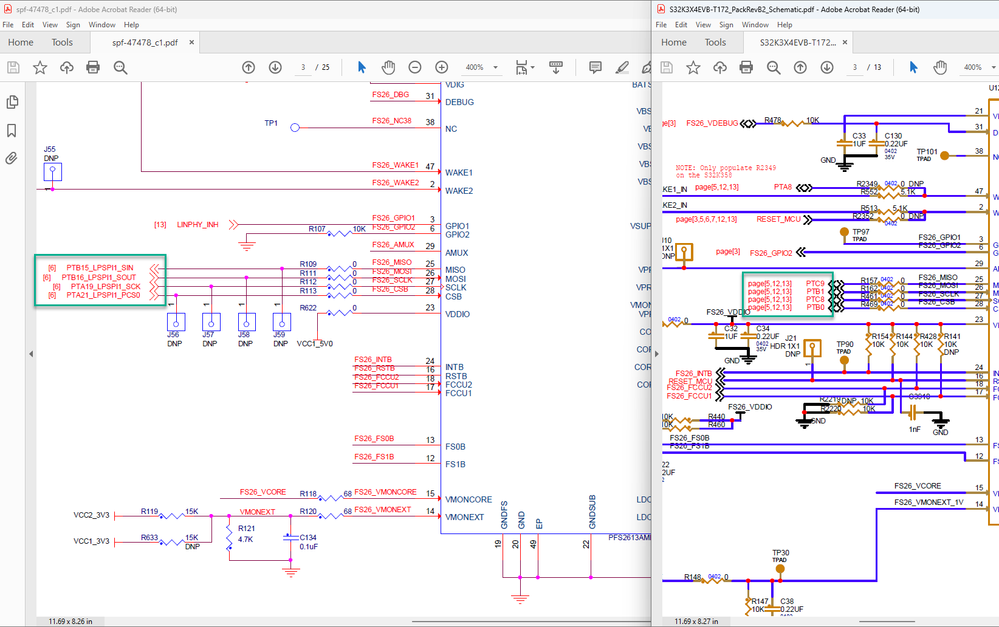

Although these examples are not based on the S32K344-WB (note the difference in SPI pins), the accompanying S32K3 RTD is the relatively new RTD 6.0.0.
SPI pins difference between S32K344-WB and S32K3X4EVB-T172_RevB2 and.pngSPI pins difference between S32K344-WB and S32K3X4EVB-T172_RevB2 and.png

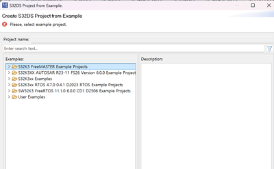

JungkyuHan1
Dear @Robin_Shen
Thankyou for support.
I am afraid the Example file of you mentioned is EMPTY.
Please Check again.

Robin_Shen
Please unzip this .zip file and then install the .exe file.

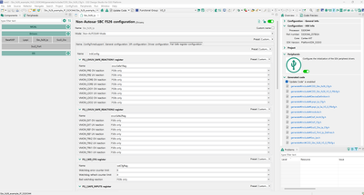

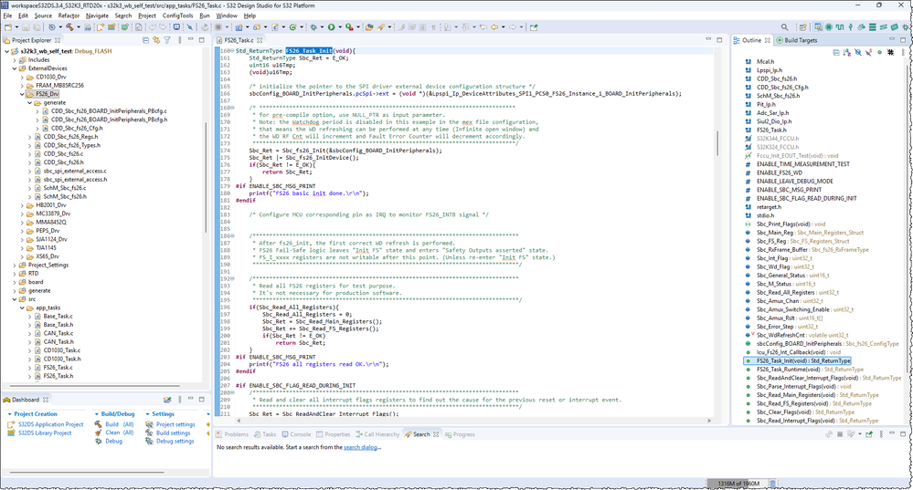

Unfortunately, s32k3_wb_fs26 uses MCAL's Sbc_fs26 in the S32DS Peripherals Tool.
s32k3_wb_self_test does not use MCAL's Sbc_fs26 in the S32DS Peripherals Tool, but the project includes /s32k3_wb_self_test/ExternalDevices/FS26_Drv.
s32k3_wb_self_test ExternalDevices FS26_Drv.pngs32k3_wb_self_test ExternalDevices FS26_Drv.png

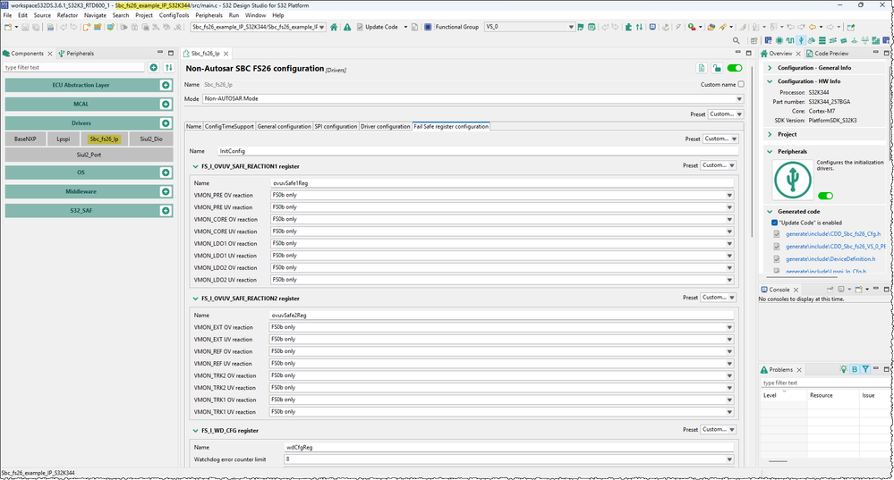

Alternatively, you can refer to Sbc_fs26_example_IP_S32K344 to see how to use Sbc_fs26_Ip in the S32DS Peripherals Tool.
Sbc_fs26_Ip Non-AUTOSAR MCAL Sbc_fs26_example_IP_S32K344.pngSbc_fs26_Ip Non-AUTOSAR MCAL Sbc_fs26_example_IP_S32K344.png

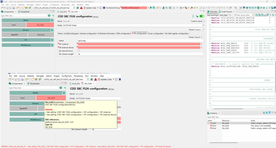

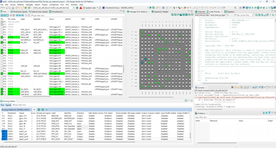

JungkyuHan1
Dear @Robin_Shen
Thank you for response.

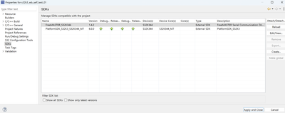

I have tried to build WB_self_test but faced some errors and I have no idea how to fix it.
Please help.
JungkyuHan1_2-1767328078770.pngJungkyuHan1_2-1767328078770.pngJungkyuHan1_3-1767328093043.pngJungkyuHan1_3-1767328093043.png
3,734件の閲覧回数
Robin_Shen
If you choose Sbc_fs26 in MCAL, you need to configure the Spi in MCAL accordingly. Refer to Sbc_fs26_example_HLD_S32K344.
If you choose Sbc_fs26_Ip in Drivers, you need to configure the Lpspi in Drivers accordingly. Refer to Sbc_fs26_example_IP_S32K344.
