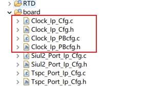

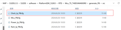

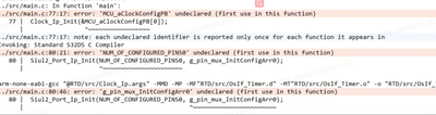

When I refer to this example for learning, i get trouble in some variable undeclared
i  compare my blank project and example project,  the `Clock_Ip_xxx`missing under /borad
and i found template of them
so how should i config the project to generate this files successfully?

oh, i got it , i miss "Intctrl_Ip_Init" in main, hardfault is called by the func inside callback, all routine operate suceesful

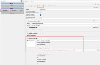

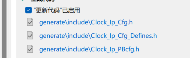

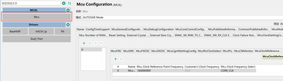

Now i add mcu module config and update OsIfGeneral, files generated in dir "generate", but siul2 part didn't update successful, is there a reference for the latest edition?
