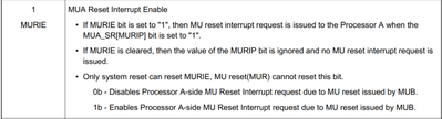

1、According to the above description, MU Reset can trigger an interrupt, but the corresponding interrupt service function was not found?
2、Help to tell the corresponding interrupt service function

The MU has 9 interrupt sources on each side. There are 1 general-purpose interrupt and 8 RX/TX interrupt sources.
The reset has a different function from the MU or system perspective. Please refer to section 39.3.3 Resets of S32K3xx Reference Manual, Rev. 5.

MUB_CR【MURIE】的作用是什么?使能后不是应该触发中断吗?触发的是哪个中断呢?

Hi @1260784871
Setting the MUR bit to 1 and enabled with the MURIE bit resets both the MUA-side and MUB-side, forcing all control and status registers to return to their default values.

1260784871
我问的是中断!文档里面不是说会触发中断吗?触发哪个中断
