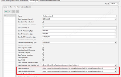

Hello, I am using S32 DS to configure the S32K344 EVB program. Can I use the configuration tool to configure the PORT and clock module, and then use the MCAL of this tool to configure other peripherals? For example, CAN, DIO
Because the configuration interface of this tool is more friendly, but we need to use AUTOSAR, can we use it in combination?

Yes, use can use the configuration to to config Port and clock module. But user also need to configure the MCU MCAL configuration because other modules (Eg: can) get the reference clock value from MCU module.
