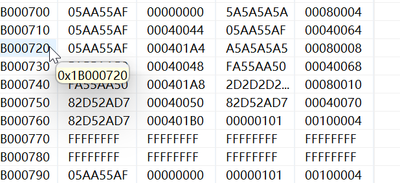

Hello Team,
I am currently working on S32K344, we want to know, how to enable lockstep core in S32K344.
I have referred below community post,
Solved: S32K344 Lock-step kernel - NXP Community.
One thing is not clear, how to know, address for UTEST_MISC to enable/ disable lockstep.?

petervlna
There is no fixed address of UTEST_MISC. It is not a register, it is a DCF (device configuration record) which is during reset phase copied to corresponding register/ registers.
You will program UTEST_MISC record into the UTEST memory in user area to the first available space.
It is in this area:
First available space is filled with 0xFFFF_FFFF_FFFF_FFFF which is stop record. So load you DCF record here.
Peter

nirmal_masilamani
Hi @petervlna ,
Below image id the data available in 0x1B000700, so i need to copy my DCF record in 0x1B000770?
Can you give me an example for DCF Records, to enable Lockstep
Is there any document for DCF details?
タグ(2)
4,338件の閲覧回数
petervlna
Yes, that is correct.
Here is how the record should looks like:
at address  0x1B000770 you will load: 0x0010000400000101

The example code for UTEST programming is here:
https://community.nxp.com/t5/S32K/S32K344-Lock-step-kernel/m-p/1930030
Here is DCF configurator:
https://community.nxp.com/t5/S32K-Knowledge-Base/S32K344-DCF-Configurator/ta-p/1986243
For lauterbach debugger:
data.set 0x1B000790 %QUAD 0x0010000400000101 ;dcf_client_utest_misc
and in S3 record for PE Micro and other:
S30D1B00077001010000040010005A
Peter
