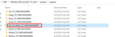

We are using S32K3X4EVB-T172 Evaluation Board, but I cannot find example code for Ethernet (EMAC) in RTD package. I only see GMAC example.
Could you please share where can I get example code of EMAC?

Why did you think that example is for GMAC not EMAC.
You can see as below:
This means that S32K344 just supports EMAC not GMAC and the example S32K344 was attached in the package is for EMAC not GMAC.

In RTD package, I only see GMAC in plugin name of ETH:
But this supported EMAC HW also.
