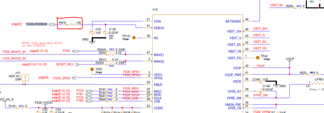

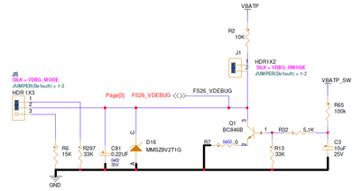

Accroding to S32K344 EVB circuit.
1. The votage of FS26_VDEBUG is 7.2 (12*15/25), How can it enter debug mode(VDBG(2.5V < debug pin < 6V))?
2. What's the purpose of BJT circuit? It makes debug pin voltage drop to 0V after ~80ms

Hi@Eason_L
1.you may forget still have 10K resistor in the picture
2.After VBAT_SW is powered on, it will turn on Q1 and pull FS26_VDEBUG low to 0V

1260784871
after resistance R478 , the voltage test is still 7.2v,why?

Hi Senlent,
Thanks for the first question. About second question, Why does it need to turn on Q1 and pull FS26_VDEBUG low to 0V? It seems unnecessary.

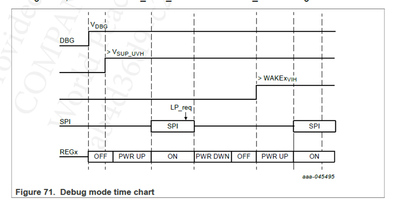

Senlent
Hi@Eason_L
For OTP mode(Flash MODE), it is necessary.
please take a look at the below two chapters:
Rev.3
Chapter 23 OTP and Debug mode
When the OTP configuration is complete, the fail-safe state machine will start in Debug mode when the voltage at the DEBUG pin is below VNORM_max (NXP recommends applying 0 V or GND).
