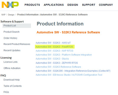

Hello All,
We are trying to use S32K3 with FreeRTOS and MPU enabled. I have created only one task using "xTaskCreateRestrictedStatic" function and when I set the task to be privileged then it works fine but setting it as unprivileged task then I get memory Manager exception.
I am using the following setup:
1. FreeRTOS version 10.5.1
2. Port.c taken from FreeRTOS GCC Port "ARM_CM4_MPU"
I have also updated the linker file as per recommendation in FreeRTOS document and it looks like this:

"2. Port.c taken from FreeRTOS GCC Port "ARM_CM4_MPU""
- we have a port and examples directly for S32K3 as a part of S32K3 Reference Software:
https://www.nxp.com/webapp/swlicensing/sso/downloadSoftware.sp?catid=SW32K3-REFSW-D
So, my suggestion is to start with this port to see if it solves the problem.
Lukas
