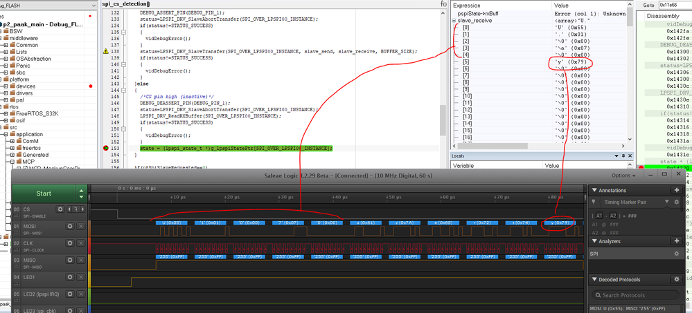

antoine_monmarc
Contributor V
We have implemented the CS pin detection IRQ. The CS pin state change works fine.
In the IRQ handler we are doing the following:
static void spi_cs_detection(void)
if(bIsSpiCsPinActive()==true)
LPSPI_DRV_SlaveAbortTransfer(SPI_OVER_LPSPI00_INSTANCE);
memset(slave_receive, 0xFF, BUFFER_SIZE);
memset(slave_send, 0xFF, BUFFER_SIZE);
LPSPI_DRV_SlaveTransfer(SPI_OVER_LPSPI00_INSTANCE, slave_send, slave_receive, BUFFER_SIZE);
else
LPSPI_DRV_ReadRXBuffer(SPI_OVER_LPSPI00_INSTANCE);
PINS_DRV_ClearPinIntFlagCmd(SPI_CS_PORT, SPI_CS_PIN);
Problem is, the rxBuff is always truncated:
Also, we always get a LPSPI_TRANSMIT_ERROR in the LPSPI_DRV_SlaveIRQHandler:
8,757 Views

razva_tilimpea
The solution for your problem is on second post.
Because the LPSPI hardware doesn't have any method to detect when CS is negated you must use another GPIO pin to monitor CS pin and when the transfer is done (CS switch from low to high) you can call transfer abort function.
Razvan
