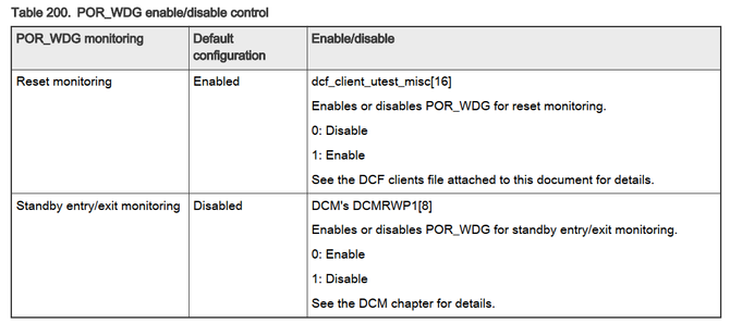

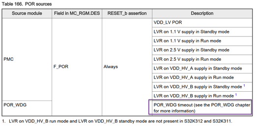

During testing, it was found that when S32K312 was in standby mode and the Reset signal was pulled down 0-25ms, the reset reason obtained was wake-up reset: MCU_ WAKEUP_ REASON.And Reset signal are pulled down for 30ms or more, the reset reason obtained is power on reset: MCU_ POWER_ ON_ RESET. May I ask why this situation occurs?Thanks!

4,182 Views
danielmartynek
Hi @feiyiniu,
This would be the POR_WDG.
Please have a look at the RM, Chapter 34 Power-on Reset Watchdog (POR_WDG).
4,123 Views
feiyiniu
The POR_WDG configuration is valid in standby mode, but invalid in normal mode. It can be understood that the POR_WDG configuration is only available in standby mode?
Thanks!
4,106 Views
danielmartynek
Hi @feiyiniu,
It depends on the DCF record, but by default it is enabled:
BR, Daniel
