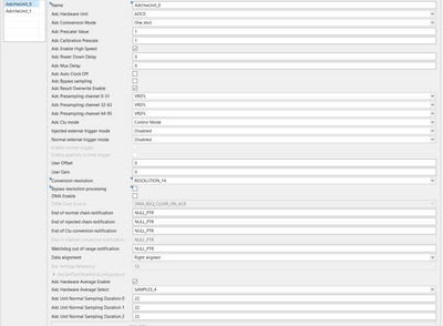

I configured ADC-0 and ADC-1:
And also i configured related channels
ADC-0:
ADC-1:

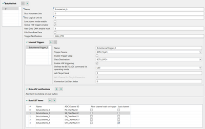

BCTU configurations:

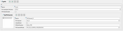

TRGMUX and PIT configurations:

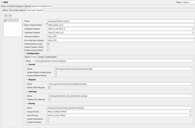

DMA configurations:
Even though I made all these configurations, no data is written to the buffer I gave to DMA.
When I check FIFODR1 with debug, I see the data, but FIFO does not run DMA for some reason.
When I reviewed the driver functions, I saw that bctu turns off the DMA hardware request every time the transfer ends in DMA configurations.
To prevent this, the function named Bctu_Ip_FifoDmaHandler is called within the Bctu_Ip_Bctu0Fifo1DmaComplete function. Thus, the DMA hardware request is refreshed.
What I want to ask here is who calls the Bctu_Ip_Bctu0Fifo1DmaComplete function and when. Could it be related to my problem?
What am I missing so that DMA can work and an interrupt occurs in the DMA major loop?

if you perform parallel conversions, in your case trigger 2 ADCs per single BCTU trigger, then you have to config list to have 2, 4, 6, ... items. Then set DMA transfer accordingly.

So even if I have 5 channels, I must also configure the 6th channel for it to work properly, am I right?.
BCTU makes the DMA transfer configurations, do I need to do it again manually?

yes, you should have 6 channels in BCTU list.
Not sure in RTD3.0.0 but in previous DMA must be configured manually.

When I tried to debug mode, I got a Source Bus Error in the eDMA ES (error status) register.
Does it need permission to access the SRAM of the DMA module? If it has how can I do that?
