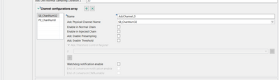

I configured ADC-0 and ADC-1:
And also i configured related channels
ADC-0:
ADC-1:

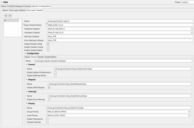

DMA configurations:
Even though I made all these configurations, no data is written to the buffer I gave to DMA.

did you call BCTU init after DMA init? BCTU init configures selected DMA ch TCD, so it can be cleared by DMA init.

per my understanding as BCTU configures the DMA TDC for specified channel and make DREQ cleared, as you wrote, you will need to enable DMA channel interrupt in code, and put Bctu_Ip_Bctu0Fifo1DmaComplete as interrupt callback within DMA setting.

When I tried to debug mode, I got a Source Bus Error in the eDMA ES (error status) register.
Does it need permission to access the SRAM of the DMA module? If it has how can I do that?
4,620 次查看
PetrS
