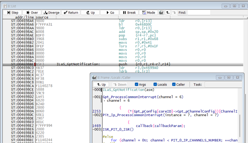

When I test GPT like below, GPT works fine.
/* Test for GPT */
Gpt_EnableNotification(GptConf_GptChannelConfiguration_GptChannelConfiguration_Iseled);
Gpt_StartTimer(GptConf_GptChannelConfiguration_GptChannelConfiguration_Iseled, 100);

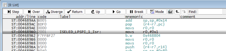

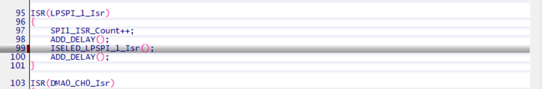

2. LPSPI_1_Isr handler is okay.
When I trigger LPSPI interrupt forced set LPSPI_1 register (TDIE), ISR called.
And it called ISELED_LPSPI_1_Isr() to ISELED library.
