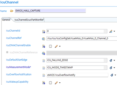

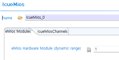

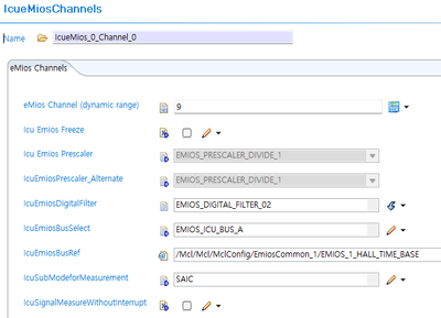

We are currently in the process of configuring the ICU Timestamp function on the S32K311 and would like to make an inquiry regarding this matter.
At present, the ICU is using eMIOS1 channel 9 (eMIOS1_CH9). However, we have observed abnormal behavior where the IRQ is triggered, on average, within approximately 1 ms after configuration and execution. We would like to confirm whether this issue is due to a configuration error.
Please refer to the attached image. We have reviewed the S32K311 Reference Manual, but were unable to find a detailed explanation regarding the ICU Timestamp mode. Therefore, we would appreciate it if you could provide any relevant documentation or advice.

Hello @NewbieNerd,
I don't see any issue in the configuration you posted here.
I understand you cannot share the whole project here, but If you could share all the ICU related APIs as you call them, I can review it as well.
Could you test it separately with the filter enabled, I think this could be the root cause.
Can you monitor the input signal with an oscilloscope?

NewbieNerd
Thank you for your response.
The RTD revision is R21-11_3.0.0_P07.
Currently, only eMIOS_1_ch9 is used in the ICU; other eMIOS1 channels are not in use.
The interrupt vector being used is eMIOS_1_11_8 (072).
The same issue occurs even when the overflow notification option is disabled.
The values read from the continuously triggered notifications are identical.
Looking at the memory stack, the event is called twice in a very short time — once in Emios_Icu_Ip_ReportEvents and once in Emios_Icu_Ip_TimestampHandler.

NewbieNerd
Due to security policy, we regret to inform you that we are unable to provide the requested file.
The issue has been resolved through a workaround; however, the root cause has not yet been clearly identified.
The issue and resolution process are as follows:
After the notification was triggered in Icu_ReportEvents, the same notification was triggered once again in TimestampHandler.
The values measured in both notifications were identical.
Subsequently, after disabling OverflowReport and applying the Filter Bypass setting,
the symptom where the same notification was triggered twice within 1ms no longer occurred,
and only the intended single notification was observed.
At this point, we are unsure how to interpret this behavior.
We would appreciate your guidance on whether this symptom suggests a structural or configuration-related issue.

NewbieNerd
After reviewing the issue from multiple angles, we suspect that the behavior is caused by the overflowNotify setting.
The system works correctly regardless of whether filter_bypass is used or the filter is set between 02 and 16.
We truly appreciate your support and the effort you put into helping us identify the issue.
Best Regard
3,988 Views
NewbieNerd
For reference, the input source to the ICU is a 64 Hz signal with a 50% duty cycle.
